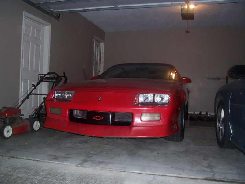

Car looks fine without it. Whats the car that's parked beside the Camaro?
My 1993 Lexus IS 150...
If you actually googled this up, then I've got some bad news for you...
Wizegui is offline   Reply With Quote
My sister's Dodge Stratus R/T. I'm reasonably sure it's just a Dodge-branded Eclipse. It has a Mitsubishi 3.0 v6 in it. It's sorta fast... almost. They're supposed to weigh something like 3300 lbs and they've got about 200hp I think. When my car was stock it would have probably beaten it. lol.

Nothing big to report but I have a video.
+ YouTube Video
ERROR: If you can see this, then YouTube is down or you don't have Flash installed.
Please excuse my really, REALLY redneck sounding friend. He's a good ol' boy but he's halfway through an engineering degree, not a dumb guy. Im just ranting abuot nonsense through most of this but unless you've got good ears you wont be able to hear it.
Got some really cool pics of the car too.
http://i232.photobucket.com/albums/ee213/InfernalVortex/082109/KWPS7.jpg
http://i232.photobucket.com/albums/ee213/InfernalVortex/082109/KWPS8.jpg
And here is anotehr friend's 79 Z28... This car needs a bit of work though... well, a lot of it. There's pretty much nothing in the drivetrain I'd keep except maybe the engine block and MAYBE the transmission.
http://i232.photobucket.com/albums/ee213/InfernalVortex/082109/KWPS2.jpg
http://i232.photobucket.com/albums/ee213/InfernalVortex/082109/KWPS4.jpg
And this is probably gonna be my last post in this thread for a while. So enjoy it guys.
