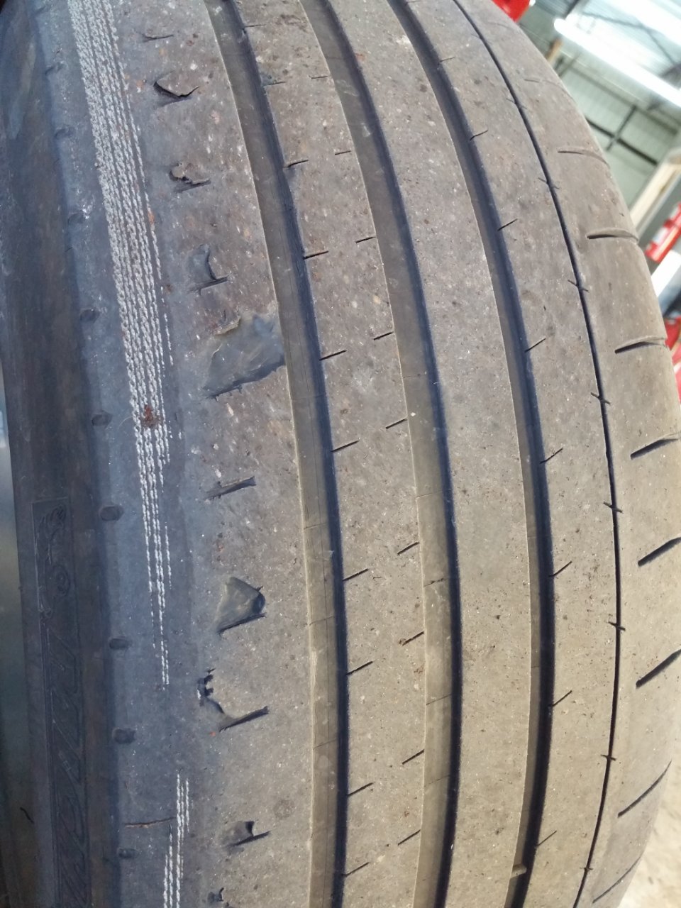

Went to have my Stoptech brake kit installed, and asked my mechanic if he could look at the source of the vibration that afflicts my car between 105 and 120km/h, that has been getting worse lately.
This is what both my front tires looked like:
So now I have 4 new tires ordered that will be going on tomorrow morning, and another alignment scheduled as well. Tire size will go up from 215-45R17 to 225-45R17 for better fitment on the 8" wide MSW wheels that went on earlier this year.

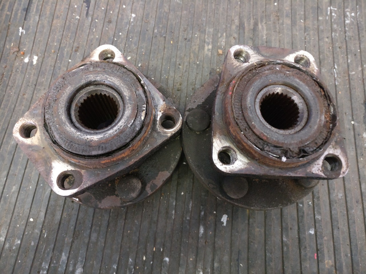

So in late August a pretty bad sound started, and I was pretty sure it was one of the front wheel bearings. I had it checked out at a suspension specialist, but after inspection and a road test he wasn't sure, so suggested I wait it out.
Fast forward a month later, and the noise is now maddening, and disapear when I turn right, pretty much confirming the wheel bearing theory. So back to the garage, and this time they confirm right front wheel bearing bad, left front on it's way too.
So many $$$ later, the car is fixed.
Here are the old bearings:
